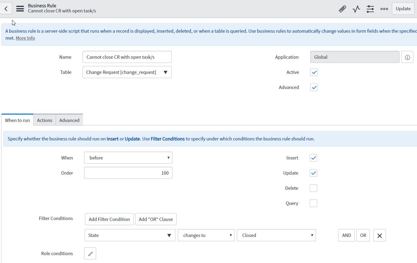

Hello Zachary,
In your above post, you did not mention what exactly the problem with the BR is.
Anyway, if you are trying to achieve exactly the same outcome as Peggy and you are testing the BR pasted earlier -> then, first ensure you are using the correct values of your Change Tasks' states in the script. Secondly, I would do the following change in the Business Rule of yours -> it will be to change the Filter Condition of it to State | changes to | Closed instead of State | is | Review. After that everything should be OK and your goal will be covered.
