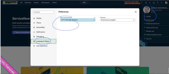

01-16-2026 03:47 AM
@Ankur Bawiskar
Strange but when I am running your code , I am getting different output.
01-16-2026 04:14 AM
did you try changing your date format?
It worked for me with any date format
did you try with other date?
01-16-2026 04:27 AM
Yes, for other dates too same kind of miscellaneous answer
