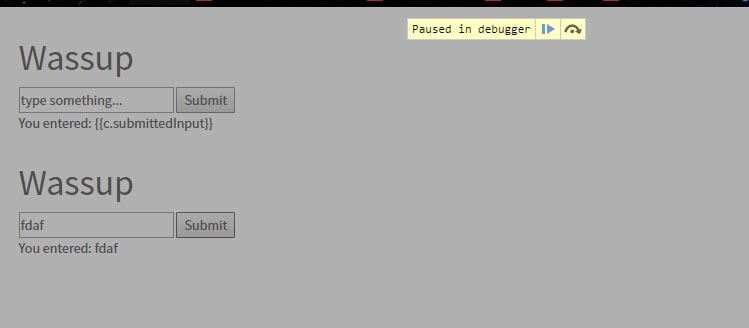

I believe input will never be populated in that code, because server.get() or update() are not called. You can get the search parameters, but I kind of stopped writing the snippet and didn't use the parameter because I could already tell it was refreshing. For instance, if I use the code posted below, with a break point in the Client Script, I will hit it when the page loads and when I call search().
This reloads the controller, and I think I have two for a moment as you can see in the screen shot below:
This is the behavior that is confusing me... I do not want the client script to be refreshed when I call search().
I added in getting the value from the URL, but the page is refreshing, so this is still not desired behavior.
