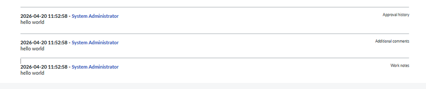

04-19-2026 06:57 PM
I take it to mean the journal list type fields. Journal fields contain the input and the log both whereas journal list only contains the log part. So when you update work_notes it does not show up as changes on the ge of work_notes_list.
var current = new GlideRecord("incident");
current.newRecord()
current.comments.setJournalEntry("hello world") //journal input
current.work_notes.setJournalEntry("hello world")
current.approval_history.setJournalEntry("hello world") //journal
current.update()
gs.info(current.comments_and_work_notes.changes()) //journal list - false
gs.info(current.work_notes_list.changes()) //journal list - false
gs.info(current.approval_history.changes()) //true
gs.info(current.comments.changes()) //trueThe docs are wrong on many occasions
