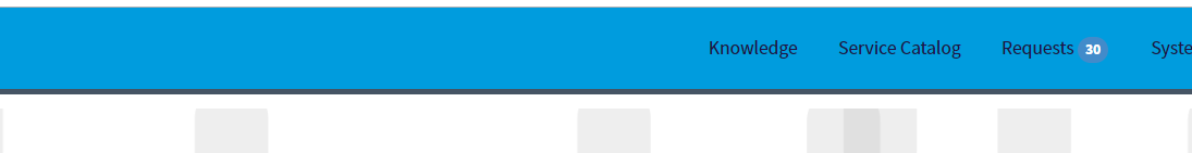

How to change the color of the top banner in service portal?

In the left nav of service now go to Service Portal > Service Portal Configuration.  A new windows will pop-up and when it does click on Branding Editor.  When the branding editor opens click on the Theme colors tab and then change the color of Navbar Background.

Thanks Brian, just what I need it.
