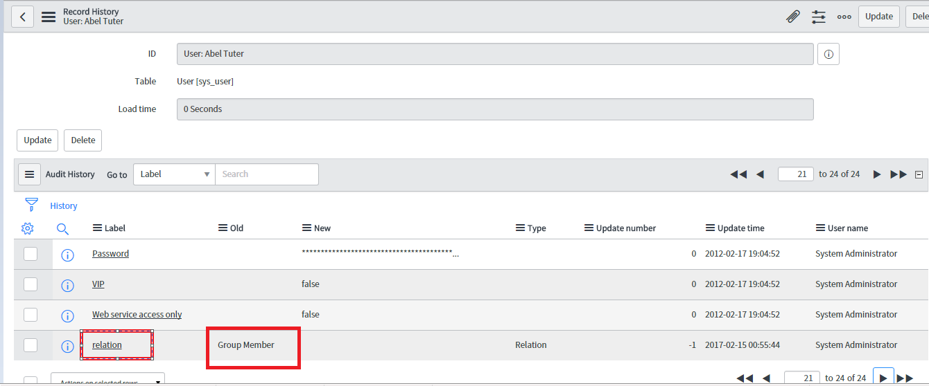

In order to check whether a particular member was a part of group or not you need to navigate to that User profile. Right click on the form header and then click on History-->List as shown below:
If you are not able to see the List option highlighted above in User profile then you need to Turn the Auditing for the user Table as per the steps mentioned below:

Once the Auditing has been turned on follow the below steps to check on your requirement:
Post click on the List scroll down to the "Audit History" tab and check for the Label/Type as "relation" as shown below:
Open the particular Relation record where you can find the name of the Group from which the user was removed as shown below:
