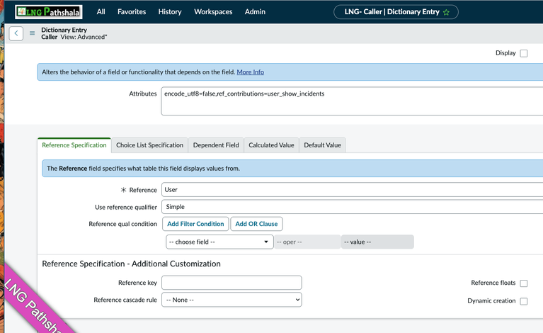

Hi @PoonkodiS
https://www.servicenow.com/docs/r/xanadu/platform-administration/c_AutoCompleteForReferenceFields.ht...
The purpose of the configuration is to set up an auto-completion feature for a reference field in a ServiceNow form. This feature enhances user experience by providing suggestions based on user input, specifically for the department field.
Key components include:
- ref_auto_completer=AJAXTableCompleter: This parameter specifies that the auto-completion should be handled by the AJAXTableCompleter class. This class is responsible for fetching data asynchronously from the server to provide real-time suggestions as the user types.
The Reference Completer is working correctly: it shows your search term and displays names that match.
The Reference Choice shows the count of matching results. When you search for a user, it displays the first 25 matching entries.
