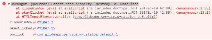

I'm working on a form, and I have a onChange script that opens a GlideDialogWindow which has two buttons, Cancel and Print. The Cancel button executes GlideDialogWindow.get.destroy() and the Print button runs a javascript function to print the form. The form prints correctly and everything, but once the print dialog window closes, the GlideDialogWindow is still there and it won't return to the form.
Here's a screenshot of the UI Page that gets called via GlideDialogWindow function from the onChange script. The print_form is the id of the div containing the verbiage that is to be printed.
In the Javascript console, I get the following

Thanks for the response. I tried this out and I got the following error in the javascript console:
i think, after print it is not recognizing any servicenow API

That's what it seems like to me as well, but I don't understand why. I've verified this behaviour in Chrome/IE/Firefox.
