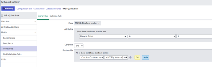

MS SQL Database
  • Must NOT be marked incorrect/absent if:
    • Contains :: Contained by → MSFT SQL Instance

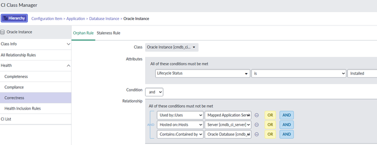

Oracle Instance
    • Used by :: Uses → Mapped Application Service
    • Hosted on :: Hosts → Server
    • Contains :: Contained by → Oracle Database

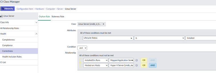

Linux Server
    • Installed on :: Runs → Mapped Application Service
    • Hosted on :: Hosts → Hyper‑V Server

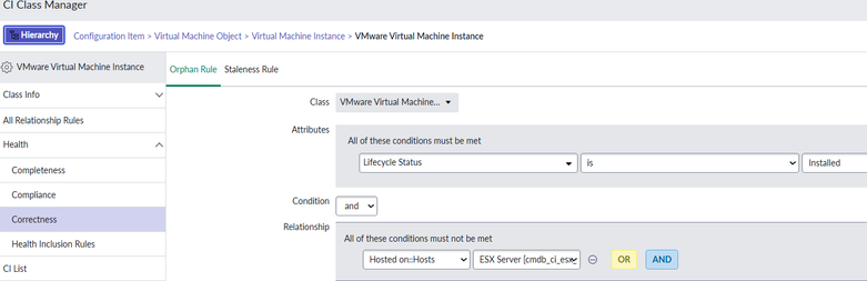

VMware Virtual Machine Instance
    • Hosted on :: Hosts → ESX Server

(Reference screenshots attached for correctness rule configurations.)
1. MS SQL DataBase Rule
2. Oracle Instance
3.  Linux Server
4.  VMWare Virtual Machine Instance
