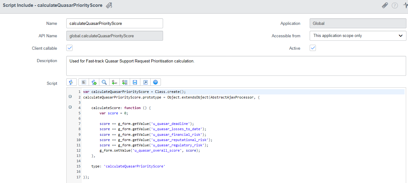

Hi Stephen,
Yes, I was using a separate table and storing values in it. I have now changed the fields to choice and added options of High, Medium and Low with values of 5, 3 and 1 respectively for each. I also created the new script include and onChange client scripts and disabled all previously created scripts. However, it does not seem to work. Am I missing something?
New script include:
Client script (x5 for each field but using same script):
Thank you!
Why do you have g_form functions in script include ? The suggestion was to create a client side function in a onload client script.
