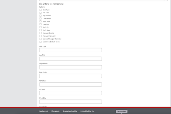

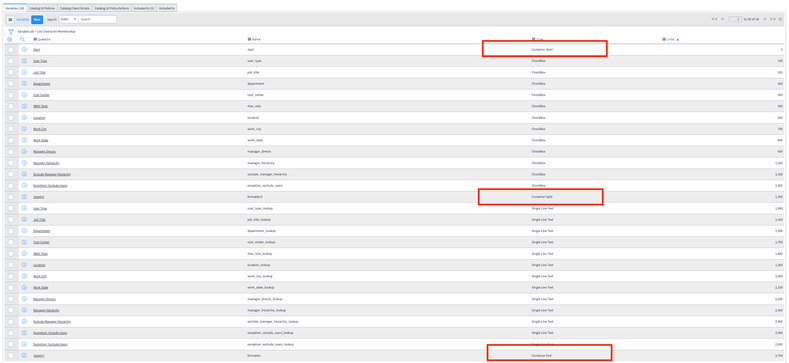

I have a variable set on a catalog item that has a container start, container split, and container end. The variables are not behaving as expected though. I want the checkboxes on one side, and the string fields on the other, but its just putting them on top of one another:

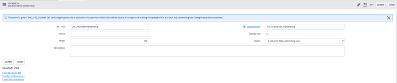

Use Container End at the start of the variable set and this will solve your issue.
04-25-2025 01:28 AM
This doesn't make any sense, but it worked. Thanks!
05-05-2025 06:29 AM
Hi Nicke,
It seems strange, but it has sense : A variable set is a container itself, so a container end says to end the container represented by the variable set 😉
