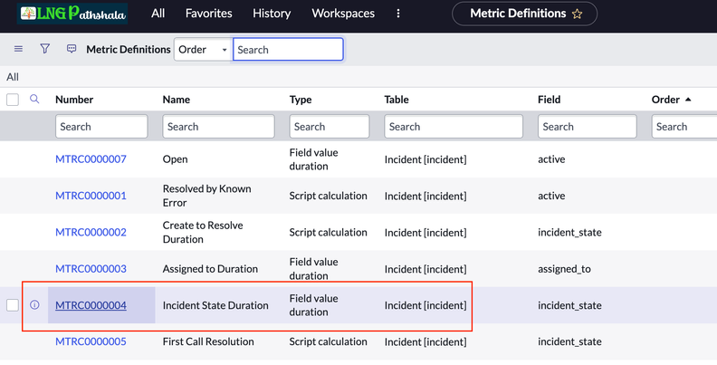

Hi @brandongtr04
I believe the best approach is to use metrics based on state. Metrics will provide the duration between two state changes, and then you can sum them up to create a report from the metric tables
Dr Atul G- LNG
https://INSTANCENAME.service-now.com/now/nav/ui/classic/params/target/metric_definition_list.do%3Fsysparm_userpref_module%3D34d59794c0a808ae00b07de5452df889%26sysparm_clear_stack%3Dtrue
