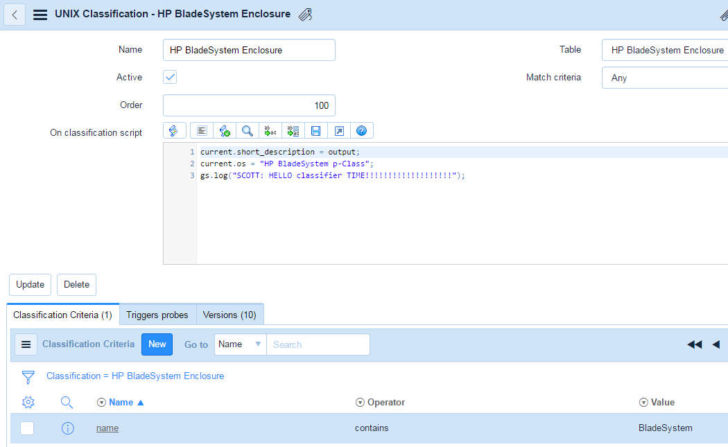

Writing custom probe for HP Enclosure device. My custom probe allows unsupported shells and does "show enclosure info" ssh command and gets back plenty of info to classify. Discovery output using custom probe says it classifies based on ssh output but then it goes ahead and tries SNMP to classify and fails. I've read that any sensor failure marks the whole discovery as a failure. Discovery output:
SNMP Classify                   SNMP probe timed out. Target is either unreachable or there are no valid credentials for it.
SNMP Classify                   Active, couldn't classify, now finished
UNIX Classify                   Unsupported shell, '$0', and probe parameter 'allow_unsupported_shells' is set to 'false'. Supported shells are [ksh, sh, bash, tcsh, csh]
UNIX Classify                   Active, couldn't classify, now finished
UNIX Classify                   Classified, now Identifying
Shazzam                                   Active, now Classifying
ShazzamLaunch         MID midhost.com discovering 10.xx.xx.xx
Discovery                             Discovery started
Debug "gs.log" statements print from my classifier and from custom sensor but not from my identifier.
Problem solved. I simply needed to add a Bladesystem - Identity probe that was triggered by my Bladesystem classifier. Thanks for the info!

I created an classifier for HP Enclosure and the gs.log statement you see in the classifier below does write to the log. Also, the discovery log I provided above does say "Classified, now Identifying". We tried SNMP discovery and it doesn't work.
