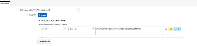

Changing it to "sys_user_grmember" would not work since if the related dependent filters are pointing to "sys_user" ref.
To solve this, I would do this below. Create a script include to return the sys ids of users that belong to that group and use a script in the condition builder.
javascript: new getGroupMembersUtil().getGrpMem();
javascript: new getGroupMembersUtil().getGrpMem('GroupName'); //You can also do this
Let me know if you have any questions:

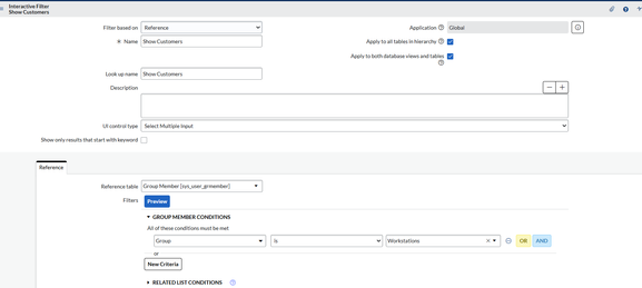

Can you show me the related list of your interactive filter? I was able to reproduce same interactive filter on my instance and it looks good.
Do you mean this?
Orginally, it was this before I tried to change the reference table to group member table.

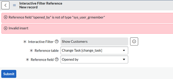

I got a similar error when I tried adding change_task opened by to as a related list reference to "sys_user_grmember" interactive filter.
I suspect that one of your related list for "Interactive Filter References" is not allowing you add this.

So you are saying that I can't modify from sys_user table to sys_user_grmember in the reference table even though I am using the User reference field? Is there nothing to fix except start over to create an interactive filter? Here is what it looks like in the dashboard,
dashboard.pngSelecting a user like Amanda came from an interactive filter using the sys_user reference table. But I want to change it to sys_user_grmember. Was it because the dependent interactive filters are depending on sys_user?
