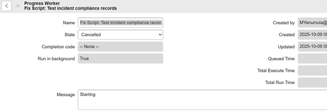

And I had created a fix script for the same use case. Once I clicked on run in background and opened progress checker. It shows error like this.

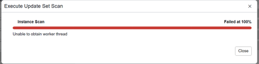

Hi Bhuvan, thanks for the reply. I tried to scan one of my update set too. It is showing error like this.
And I tried to get the node details which is causing the issue. So, for raising a ServiceNow case, do we need to show the exact details of which node is affecting the issue or can we mention the screenshots which I mentioned in this thread.

Hi @Mani Chand Yenu,
According to your error message "Unable to obtain worker thread", issue is not with your data source or transform map configuration but with the overall capacity of your instance to process background jobs. This error means that all available background worker threads on your instance are currently busy with other tasks so your new import or fix script cannot even begin to run.
To resolve this, you need to identify and terminate the long-running process. You can do this by navigating to System Diagnostics > Active Transactions (All Nodes). Look for any transactions related to your import set or fix script that have been running for an extended period and cancel them. On PDI, which has limited resources, it is also a good practice to import data in smaller batches to avoid overwhelming the system.
If my response helped, please mark it as the accepted solution and helpful so others can benefit as well.
‎10-10-2025 08:22 AM
Hi Iftikhar, thanks for the reply. When I navigated to Active Transactions (All Nodes), It is only showing one node and I think it is not related to the issue. And I tried to kill the transaction too. But it is not happening.
