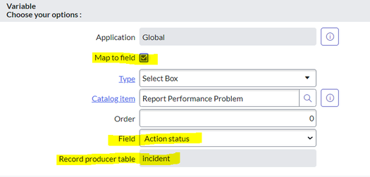

Hi @shubhamverm3478
I believe its a Record Producer make sure that while creating a field on RP "Total Amount" check map to field option to the exact field you want to be populate and that should work.
See the image :-
