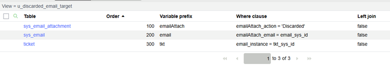

I am trying that approach. Here is my database view:
So, I am trying to get all email attachments that were discarded. Then obtaining the email referenced in those. And obtaining the task (specifically Ticket) referenced in the email's 'instance' field (which is of Document ID type).
However no record is being returned and I have 101 records that satisfy the conditions. Can anyone see what is wrong here?

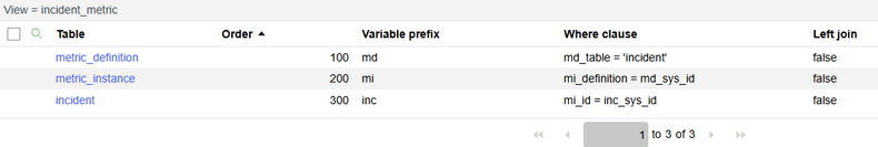

Also, this is very similar to the OOTB incident_metric one and that works fine:
Note: The mi_definition field is of type Document ID.

‎03-24-2025 10:15 PM
Hello @dp11
Please change the variable prefix of sys_email_attachment table from emailAttach to emailattach. You will get the desired output.
Note: Don't use camel casing in database views
‎03-25-2025 07:23 AM
Thanks for your reply. I changed to emailattach and still no output.
‎03-25-2025 07:33 AM - edited ‎03-25-2025 07:33 AM
Hello @dp11
Now change the Where Clause for sys_email_attachment table like below:
emailattach_action='discarded'
It should work as it worked at my end
‎03-25-2025 07:38 AM
OK, did that:
Still empty result:
And as you can see below I have 101 of such records:
