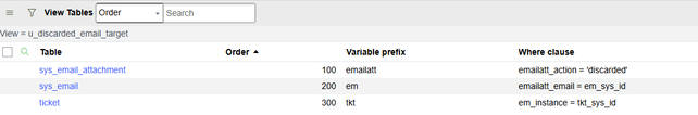

I am trying that approach. Here is my database view:
So, I am trying to get all email attachments that were discarded. Then obtaining the email referenced in those. And obtaining the task (specifically Ticket) referenced in the email's 'instance' field (which is of Document ID type).
However no record is being returned and I have 101 records that satisfy the conditions. Can anyone see what is wrong here?

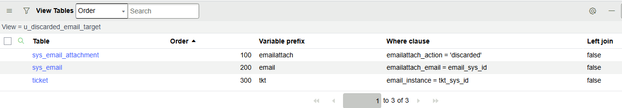

‎03-25-2025 07:50 AM - edited ‎03-25-2025 07:50 AM
I actually had it like that to start with but had added the second condition in response to Ankur's suggestion. Now have put it back like earlier but still no output:
‎03-25-2025 07:57 AM - edited ‎03-25-2025 08:06 AM
‎03-25-2025 08:07 AM
Modified to match yours but no luck 😞
If it works for incident in your case I believe it should work for any type of task. Here is one of the relevant emails whose attachment was discarded and that has the Document ID with Ticket table So I am expecting this should show up in the database view result but it doesn't.
