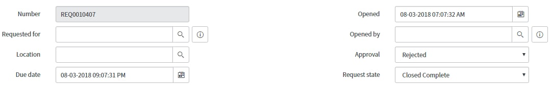

I created a copy of this notification named "Request Closed Incomplete" and changed the subject to say: "Your request ${number} has been closed as incomplete", using the same condition as active flag changes to false, but adding another condition where the approval changes to rejected:
When a service request is closed as incomplete (Approval changes to rejected), it ignores my second notification condition and sends the "Request Completed" notification rather than the "Request Closed Incomplete" notification:
I need some help getting the conditions to actually take effect so it sends the correct notification. I checked and there's no Order field on the notifications so I can't prioritize one over the other.

Mark, thanks for the reply -- I had already tried this approach and it doesn't appear to work:
And:
When I tested this, the resulting notification that sends out is still the Request Complete. The REQ is closed (active changes to false) and it sends the first of the two notifications:
It's almost like it ignores the second condition.

As for REQ State, I cannot get the state to change via business rule depending on the RITM state being set as closed incomplete. The REQ state seems to be much more complicated, so I reverted to using the approval as the deciding factor.
