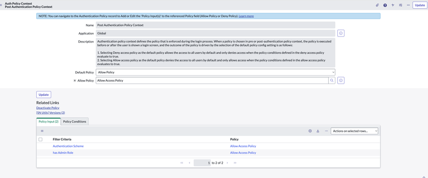

There is a feature - Adaptive Authentication, in which we can restrict the user logins based on their login types, roles that user has, groups that user belongs to, location of the user etc etc. This is an OOB core plugin and should be available already in the recent releases. If not, then please install the adaptive authentication plugin and enable the adaptive authentication feature property - glide.authenticate.auth.policy.enabled = true.

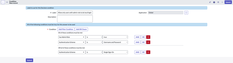

The way to implement this constraint with Post Auth Policy is this -
https://www.servicenow.com/docs/bundle/yokohama-platform-security/page/integrate/authentication/conc...
In the Post auth policy context, you can create the policy to allow only admin users to do the local login. Here is how to craft the policy condition -
Policy Inputs (need to create it if not already available) -
1: Role Filter Criteria - hasAdminRole (role = admin)
2: Authentication Type ( Authentication type = username and password / SSO Login)
Policy condition -
hasAdminRole = true AND Authentication Type = "Local Login"
OR
Authentication Type = "SSO Login"
This should be sufficient as it will make sure if the user is logging via the user name and password, then only it can do the local login. However, with this, all the users will be able to login with SSO including admin users. If you want to further refine and dont want to allow the admin users to do sso login, you can add hasAdminRole condition in the second part with hasAdminRole = false.
