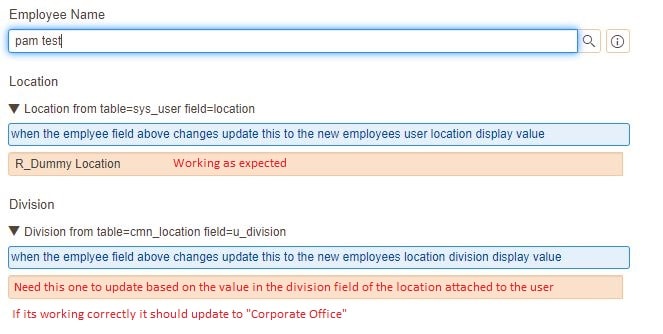

Hi Ankur,
Sorry I am new at Service Now and not great at scripting. I might be missing something but it seems you are saying that all the user information is in the sys_user table but it is not.
When a user is selected I can show the location in a read-only field using a catalogue Client Script.
The issue I have is that the next field I want to display is Division. The division is on the Location record, not the User Record.
Hopefully, some screenshots will assist?
This is the form I am testing with.
Here is the catalog Client script that works for the location field. Note the location value is on the user record.
This is the catalogue Client Script I have for the Division (Not Working) Note the division value is on the Location Record
This is the form when I select a user. Note the Division should change each time the location changes and the location should change based on the user selected.
It would be great if you could guide me in detail about what I need to do here then I will be able to extend that to other tables and fields that I need for the use case.
