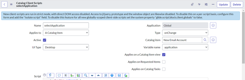

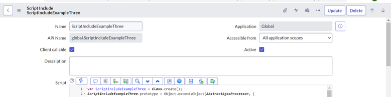

You can use "onChange" Catalog client script to initially get the value from your application field, and then send it to a script include via GlideAjax call. Make sure the script include is client callable for the same. Then put your conditions and send the value back to client catalog script and then set it to the custodian field. I have implemented your requirement via an example. Here, I am passing Abraham Lincoln as user if application is not Global and if application is global I will be passing Abel Tuter as user.
Client catalog script:
function onChange() {
var application= g_form.getValue('application');
var ga = new GlideAjax('global.ScriptIncludeExampleThree');
ga.addParam('sysparm_name', 'refqual');
ga.addParam('app', application);
ga.getXML(HelloWorldParse);
function HelloWorldParse(response) {
//alert(answer);
g_form.setValue('custodian', answer);
Script Include function:
refqual:function() {
gs.log("lolatleastscripy");
var application= this.getParameter('app');
if(application=="global")
return "62826bf03710200044e0bfc8bcbe5df1";
else
return "a8f98bb0eb32010045e1a5115206fe3a";
Script Include:

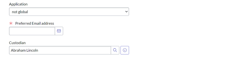

Result when application not global:
I hope this Information help you, If you find this information helpful please mark this as helpful and accept the solution. Thank you
