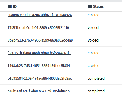

Yes I had this problem as well, there is a problem with the OOB Flow where the Status is looking for an uppercase first letter.
But when you check the envelopes table the status is all in lowercase:
Only way I found to resolve it was to Copy the Flow and update the values to lowercase and it all worked fine for me then.
