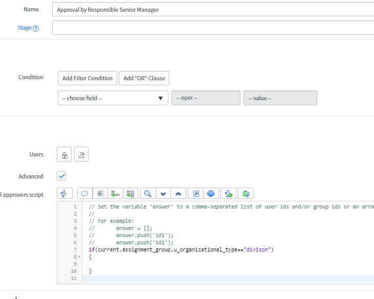

I have a requirement where if the Organizational type is division then the manager will be the approver of the change if the organizational
type is not division then it should check the parent group , it should continue until the organizational type is division and then the manager of that group should be approver of the change
Can some one help me with the script
In this example first it will check the assignment group and see if the type is division or not if not it should check for the parent in that group and see for the organizational type ,,
I am stuck with the scripting part in the approval user activity in workflow
