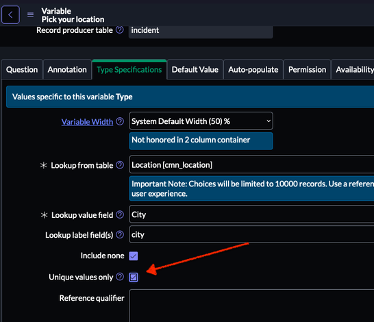

Hi @B V ,
There is a check box named "Unique Values Only" under the type specification section of a variable. You can set it to true to see only unique values. He is a screenshot attached for your reference.
