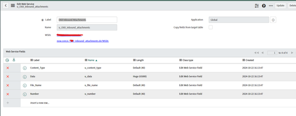

Scenario 1: To achieve this I have created a separate Inbound Import set with Target Table "Sys_Attachment" and created the below fields on the stagging form.
I created a Transform Map with a run script, but the Write() and writeBase64() methods did not work due to limitations in the global scope.
