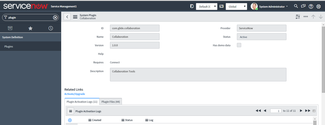

Queue under Social Application was for the Legacy Chat configuration. In order to work perfectly you need to define it under Collaborate Application Menu only. If the Collaborate menu is not activated then you need to navigate to "Plugins" Module and search for "Collaboration" and activate the same by opening the Plugin Record and then click on "Activate/updgarde" Related link as shown below:

I don't know if it was the problem, furthermore the plug-in "Collaborate" it's installed on the system.

In Order to setup a Queue, you need to define that under "Collaborate" module as shown below:
