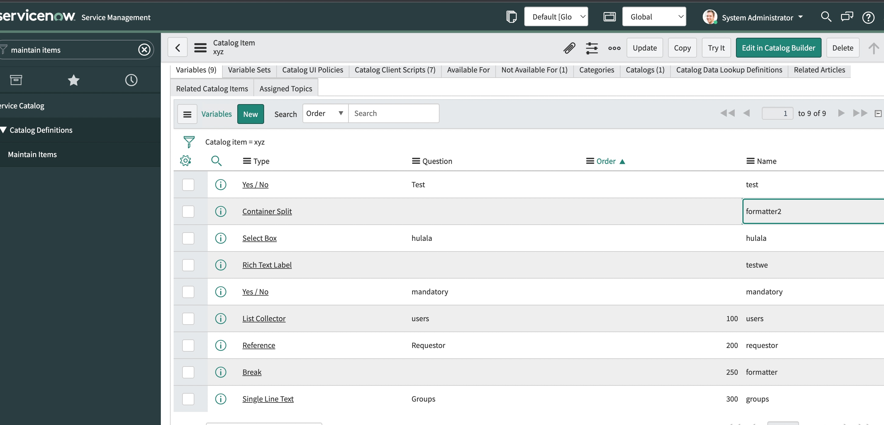

I Have created 2 variable set witch going to be use almost all other catalogs.
now I have created 2nd catalog in which I am adding same variable set but it's showing like below error I don't know why this error is coming plz let me know.(the error screen snap is in attachment)

This error means that you have another variable with the same back end name .
usually if there are two variables with same back end name it wont allow you to add the variable set
so check for the variables with names as "formatter" and "formatter 2" IN ANOTHER VARIABLE SET CALLED "DETAILS" and change the names so that it is unique from the other variable.

but we can not change the name of formatter" and "formatter 2 because it's container split and container end.

please find following article and related link which will help you to solve
https://support.servicenow.com/kb?id=kb_article_view&sysparm_article=KB0717907
From London variable set and variables with same name are not allowed and cause issues
