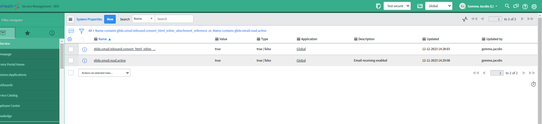

Thank you so much! This was very helpful. However, I am still having a problem or I've misunderstood.
  • I create the property glide.email.inbound.convert_html_inline_attachment_reference and set value to True
  • glide.email.inbound.convert_html_inline_attachment_reference set value to true
I am still showing an not compliant. See attached.
