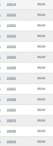

04-07-2017 10:32 AM
Hi Brian,
No change I update the end as suggest but still the same vendor number for all records.
I doubled checked my load files and the ast_table and they definitely have different vendor number for customers.
Any other suggestion?
