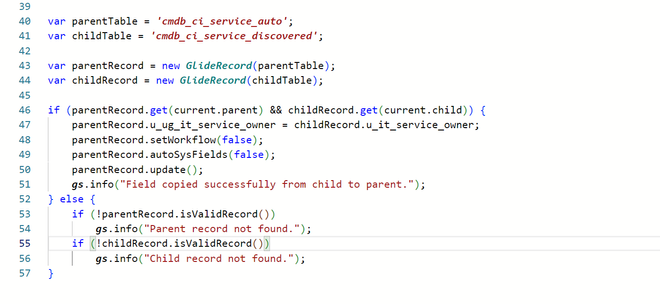

Subhashis Ratna
HI @Thalavai m
I have the same requirement and updated your code . However, you can try implementing this logic.
var parentTable = 'cmdb_ci_service_auto';
var childTable = 'cmdb_ci_service_discovered';
var parentRecord = new GlideRecord(parentTable);
var childRecord = new GlideRecord(childTable);
if (parentRecord.get(current.parent) && childRecord.get(current.child)) {
    parentRecord.u_ug_it_service_owner = childRecord.u_it_service_owner;
    parentRecord.setWorkflow(false);
    parentRecord.autoSysFields(false);
    parentRecord.update();
    gs.info("Field copied successfully from child to parent.");
} else {
    if (!parentRecord.isValidRecord())
        gs.info("Parent record not found.");
    if (!childRecord.isValidRecord())
        gs.info("Child record not found.");
SS - 1
Here i have updated as per your requirement .
If this solution resolves your query, kindly mark it as the accepted solution and give it a thumbs up.
