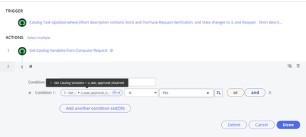

08-01-2024 11:49 PM - edited 08-01-2024 11:52 PM
Hello @MalikB ,
Please post ss of your flow so we can suggest you the required changes. But i am agree with answer by Adarsh, if you not able to access variable value in the flow then i am assuming that you need to verify that, you need to add "Get catalog variables" activity after trigger to define the required variables of the particular catalog item and then you need to access those using reference of that "Get catalog variables" activity variable in the "If" condition where you need to add it.
Refer below images as an example:

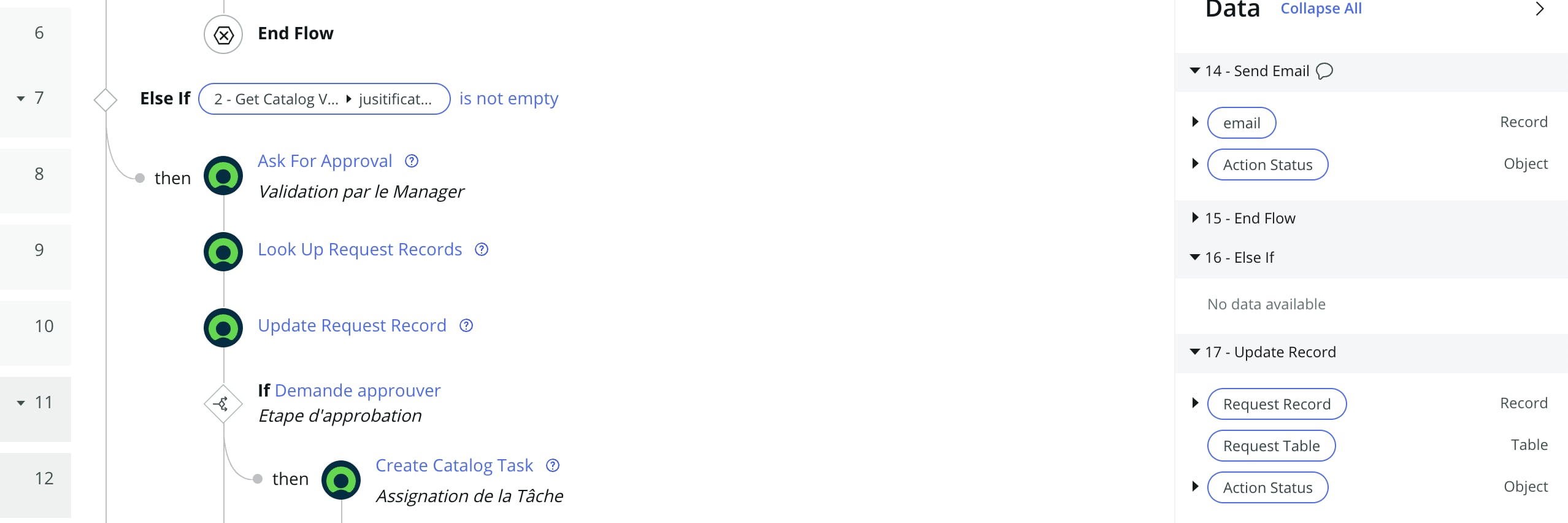

08-02-2024 03:33 PM
Hi @Dnyaneshwaree here what i could come up with in the screens i dont know if its a good way or not if you have any suggestions or corrections to my flow
