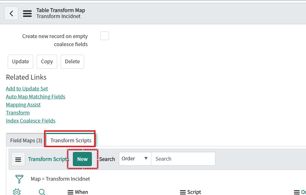

Nope you just need to define the Transform Script which is just beside the Field Map section. see image below:
Now select On After and use the script above as shown below:
