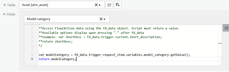

Karan Chhabra6
Hi @ray evans ,
You can toggle the inline script for the model category variable in the update record action and paste the following lines of code, replace 'model_category' with you catalog item variable name.
vat modelCategory = fd_data.trigger.request_item.variables.model_category.getValue();
return modelCategory;
