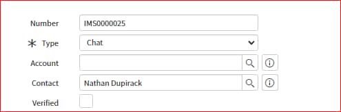

‎04-12-2022 09:12 PM
Try use onBefore insert BR and run this logic (Note: I've hardcoded the value). But you can parse the JSON value that you are receive for contact field, as per your payload. Give screenshot for the value that you are getting for the contact field a well below
Result:
