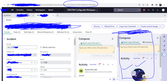

I have created a contextual search on CSM workspace, where i am calling a Activity Component which should show activity of case table, i am able to get the details in static manner, mean if i give a sys_id of case then it is showing the correct details and for this to be dynamic i need to pass the sys_id of the ticket selected on the csm workspace , how can i pass it.
CSM Workspace where i have created a new contextual search

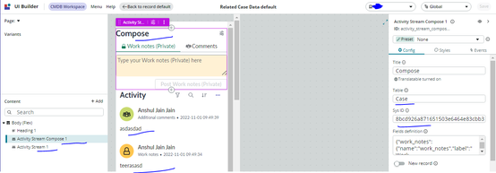

I am calling an Activity Stream Component from case table
When i am giving the sys_id directly then i am able to fetch the required details, now i have to fetch the sys_id of the ticket which is selected on workspace, how to do this. i tried adding some code under bind data and script but not able to write the correct script, can someone tell if this can be done, can i fetch the SYS_ID in update in sys_id field of component.

Michael Fry1
I'm saying put @context.props.sysId in below where you have sysID. This assumes your page parameter is "sysId".

Michael Fry1
You should be able to pull that from @context.props.sysId <- where sysId should be on your page parameter. Type it exactly has you have it on the parameter.

I did the same way but it is taking the sys_id of the first INC number not the current INC, please see below more details.
I have created a data resource, where i want to get the sys_id:
then this i am calling this data resource in component, but it is not bringing right value, what can be the mistake here.
Michael Fry1
Thank you very much, i was missing the configuration on the page, now i was able to achieve it,
