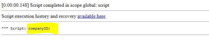

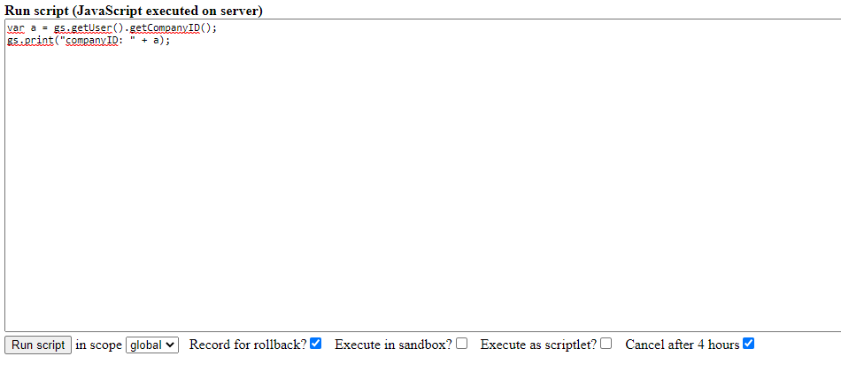

I am trying to acquire login user's CompanyID by using this code:
javascript: gs.getUser().getCompanyID();
However, when I try this code on Scripts Background, it returns blank.
Result:
One of the post said that there might be some ACL restriction from core_company table which prevent it to be read.
Anybody know how to solve this issue??
