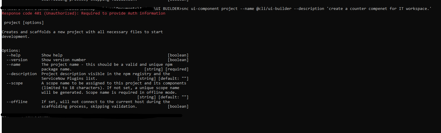

Getting an error when trying to use ui-component to set up the project.
01-22-2024 04:37 AM
I have a valid proflie that have connected successfuly
However once running below command to create myproject I am getting below error:
Command:
snc ui-component project --name @cli/ui-builder --description 'create a counter compenet for IT workspace.'
Error:
Response code 401 (Unauthorized): Required to provide Auth information
I am an admin user in the environment I am trying to access to .
Can you please helpl to undentory the reason to this error?

After chcking all above points and found that all are fine - nothing to fix on that.
I tryied a dierent approach as sggested in below post:
I followed the steps mentioned there - created a named profile , then connected to that Env after that I could create my project successfuly.
Although the original error that I got was differnt than described there -
It worked for me also.
