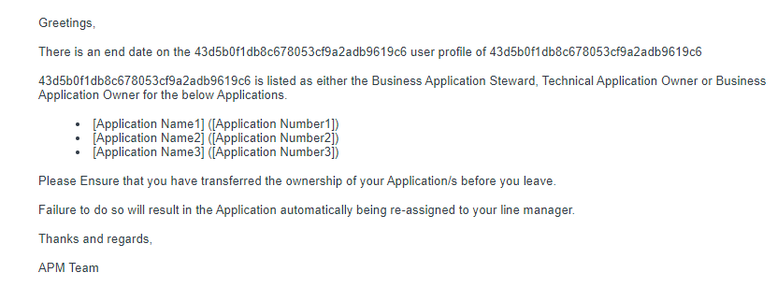

I'm wanting to obtain the end date and name fields within the second parameter into an email:
However, when I preview my notification, I'm getting sys IDs instead of the values I need:
I was wondering if somebody could explain how I get the required values so that they are displayed correctly in my email.

Please make below changes-
var grOwnership = new GlideRecord('cmdb_ci_business_app');

gs.eventQueue('lbg.notify.reassign_new_owner_DAO', grOwnership, grOwnership.u_business_owner.manager.toString(), grOwnership.u_business_owner.getDisplayValue());

gs.eventQueue('lbg.notify.reassign_new_owner_BAS', grOwnership, grOwnership.u_cmdb_data_steward.manager.toString(), grOwnership.u_cmdb_data_steward.getDisplayValue());

gs.eventQueue('lbg.notify.reassign_new_owner_TAO', grOwnership, grOwnership.u_custodian.manager.toString(), grOwnership.u_custodian.getDisplayValue());

u_business_owner field on cmdb_ci_business_app table is reference to user and you are pushing the sysId
Do this change in script for 3 lines and it will work
