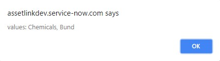

As per the screenshot I have printed the data that I am passing into the script, and it shows the correct string value is being passed in to the addParam functions.
