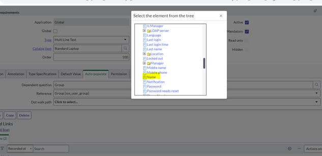

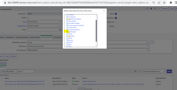

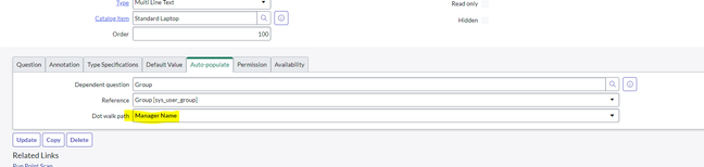

HI @johnjosephjose
While selecting the element select the (+) near to manager
Then scroll down & select name
It should look like this...

HI @johnjosephjose
