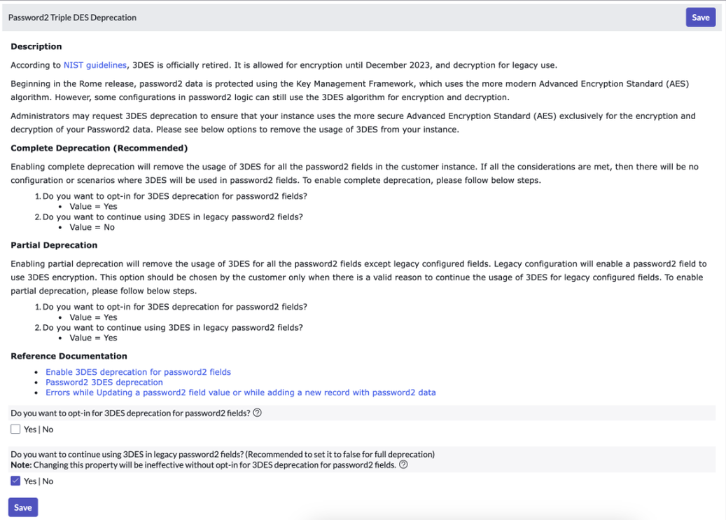

@Sohail Khilji Thanks for the reply...
But this steps are only for password2 fields right?
How to
Ensure that MID servers can communicate using alternative encryption methods (e.g., AES, or other NIST-compliant ciphers).
