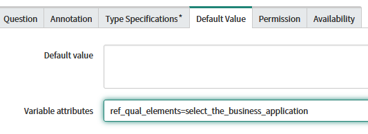

Have you set the Attribute ref_qual_elements? You need that in order for the Reference qualifier to work.
ref_qual_elements=location
You can add the Attribute to the Reference variable like so:
