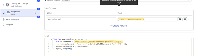

Honestly, I think it's related to your first "look up record" step and how you're receiving the "Comments" as an input (which SN doesn't seem to be able to handle). Instead of receiving the comments as an input, try and receive the entire record, and then grab the comments journal entry in your script:
var fullComment = inputs.approval_record.comments.getJournalEntry(1);
var trimmedComment = fullComment.substring(fullComment.indexOf(")") + 1);
outputs.comment = trimmedComment;
})(inputs, outputs);
Example:
