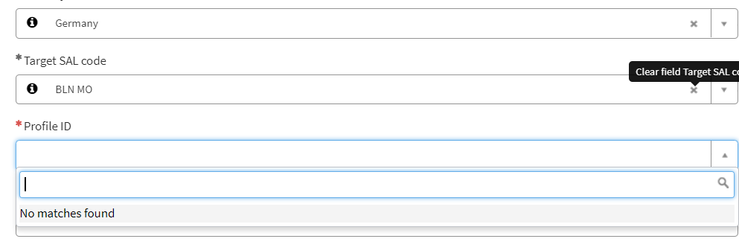

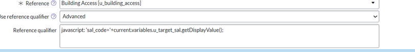

I have a reference qualifier in a variable that is referencing another variable "sal_code" on the catalog item. It has to show only the records that have that sal code in the u_target_sal field. The reference qualifier I have is not working as expected. Any help would be great!

When I am populating the SAL code I should see some data here and it is blank
sal_code is a reference variable correct? If so you could try:
javascript: 'sal_code=' + current.variables.u_target_sal;
(assuming u_target_sal is also a reference)

Hello @Patrick Cavanau ,
Can you try it as below -
Instead of using getDisplayValue() try to do dot-walking.
javascript: 'sal_code='+current.variables.u_targer_sal.name; //replace with actual var name
