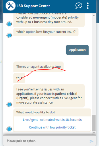

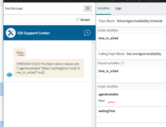

Hello! I am hoping someone can help me out with this issue. My current version is Utah and I am trying to figure out why the vaSystem.isLiveAgentAvailable() method is returning 'true' when there are no live agents connected. I have tested this in the designer and it gives me the correct result of 'false' but when I test it in a published topic, it tells me that there are agents I can chat with and when i click to be transferred, then it says there are no live agents available. I am confused and not sure what to do to fix it.
Testing from the designer - as you can see, it gives me the expected result of false

Testing from a published topic - it says that there are agents when there aren't any

I tried this approach but i keep getting the same results unfortunately. I can see the correct value when i test it in the designer but when i test it in the topic, it tells me that there are agents available when no agents are signed in. I am trying to figure out why it's giving me the incorrect value but getting no where.
Test from designer:
Test from topic:
and when i click on the option to talk to an agent, then it says there are no agents available.
