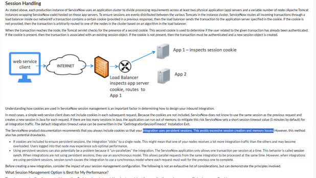

Also Refer this :
Troubleshooting inbound integrations performance for ServiceNow administrators and developers
