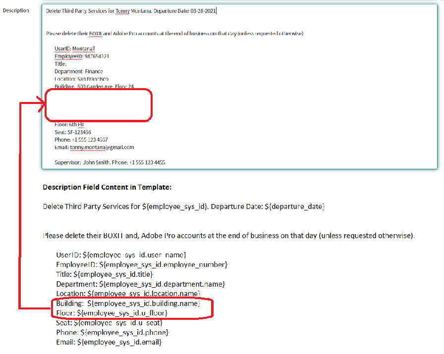

How can I get rid of blank spaces when using inline expressions inside the Description field of a Catalog Item template?
02-03-2020 07:44 AM
For some reason I get this blank spaces in between the Building and the Floor inline expressions.
I tried appending trim() to the end of the field name inside the expression, but it did nothing. I also checked for surround spaces before and after each one of them, and they are all the same.
It looks like the building.name field is an object with multiple properties where some of them are empty. I tried multiple addresses to no avail.
Building: ${employee_sys_id.building.name.trim()} Floor: ${employee_sys_id.building.u_floor.trim()}
Please see sample screenshot below

I checked the 'name' field in the sys_building table, and it looks fine, with a max. length off 100 chars. Thing is that sometimes the space gap disappears depending on the employee_sys_id used.
I am a junior ServiceNow developer with not much JavaScript experience, but I was thinking I could use the trim() function inside the inline expression to remove extra spaces from the sys_building.name field. The trim() function itself does not return any sintax error, but it does not seem to trim the space in this case. As a test, I temporarily removed the below expression from the template Description field, and the space gap disappeared, meaning the issue is caused by extra spaces in that particular field.
