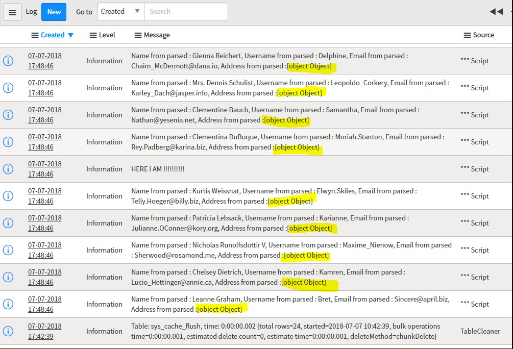

PFB screenshot.
and in the Log i can able to see a lot of records not only one record  please correct me am i am wrong .
Please use the insert funtion in a loop as appropriate and execute the query by commenting the address related fields.
and please make sure that you if you are getting multiple records  from response you have to use the insert query in a loop.
