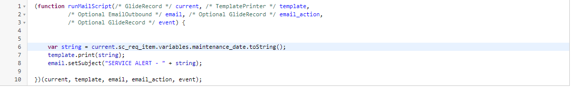

I have created an Action in Flow designer to trigger an event which will send out a notification. With in that notification I need to pass the date variable that the user inputs. I have created a template and use the mail script to print this value, but it is coming back as undefined. Here are screen shots of the Action and mail script. Not sure what I am doing wrong and any assistance would be helpful.

Mail Script:

your event is on sc_req_item table
but in the event log the table is different
Unless the event triggers on the sc_req_item table it won't work
Can you check the inputs.template object belongs to which table
try adding this log
gs.info(inputs.template.sys_class_name); // check the table name
02-10-2021 05:54 AM
Can you try to update as this if the current object is sc_req_item
var string = current.variables.maintenance_date.toString();
02-10-2021 05:58 AM
I have made the change but it is still coming back as "undefined"
